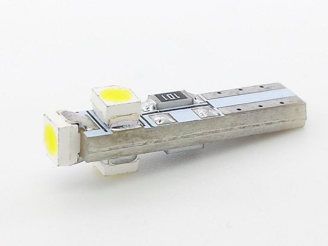

        These are the type of bulbs I used.
        Sorry the photos are so big!
        These Led's give a good spread of light & are a lot brighter than the bulbs they replaced.
        I'm guessing at the power they use.
        Each SMD approx 30mA, three per bulb = 90mA, Five bulbs = 450mA, which is quite a saving on the original bulbs but not as much as your set up.

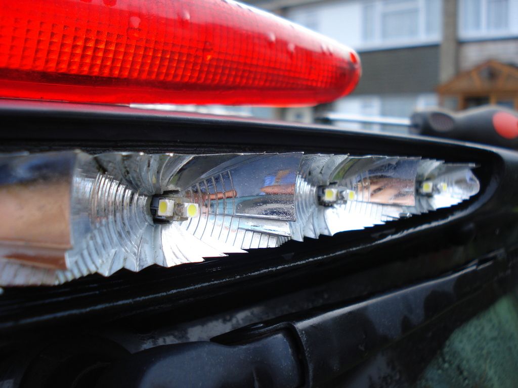

              Finally, I finished and mounted the lamp.
              Looks like this :
                Just bought ten 286 T5 LED bulbs on eBay for £1.97. Looks similar to those fitted by Mr T. Comes all the way from China so no chance they'll arrive this year.
                • 10:45PM
                  10:45PM commented
                  Editing a comment
                  Ebay ad says "Low power consumption, save your power supply.
                  LED Q'ty: 3LED Voltage: DC12V Wattage: 2W"
                  Errrm a standard filament 286 is 1.2W lol

                  Do not believe the Chinese. No way can the tiny LED bulb draw 2 watt. Its resistors would burn out because they are too small.
                • tolsen
                  tolsen commented
                  Editing a comment
                  Mine will draw less power than Mr T's because 220 Ohm resistor as opposed to 100 Ohm on his. The only worry is perhaps his is brighter.
