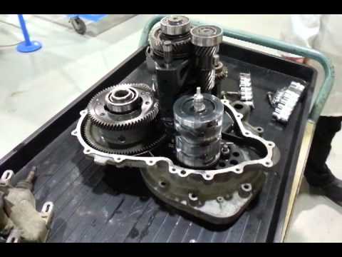

Here is a video showing a 450 transmission opened out:
One can clearly sea that only some bearings are sealed while others not. The theory that sealed bearings were fitted to safeguard against bearing failure due to small metal particles from initial transmission break in does therefore not hold water.
It is the sealed bearings that fail in this transmission. Failure mode is lack of lubrication when the grease inside the sealed bearings dries out.

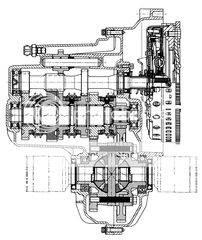

I've seen transmissions where all bearings are sealed. In that case the seals will prevent damage caused by tiny metal particles released during transmission break in. In our transmission all differential bearings are unsealed. In gear box itself, bearing nearest to clutch on input shaft is unsealed while bearing at other end of input shaft is sealed. Both end bearings on cluster gear are sealed.
The bearings that see the highest loading are those that are sealed and lubricated with grease. Using the online SKF bearing calculator one can quickly calculate bearing life. Have just done that and concluded bearing life drops dramatically as soon as contaminants are introduced. Longest calculated bearing life was with sealed grease lubed bearings and open bearings lubed with clean oil. Oil viscosity had no effect on bearing life. Clean oil and grease gave identical bearing life.
My conclusion is that Getrag design engineers had done bearing life calculations and found too short life for three high loaded bearings. A simple solution was then to specify double sealed grease lubricated bearings for these to ensure a reasonable overall expected life of the transmission. Regrettably, they did not take into consideration that the grease dries out which is why this transmission fails. The good news is that these bearings are rather cheap about 5 Pounds each and that they are very easy to replace.
Of course, changing transmission oil will drain out most of the tiny metal particles released during break in period, resulting in increased life of the open bearings inside transmission. Because the bearings that fail are sealed, renewing the transmission oil will however result in no overall increase in transmission life. That is why Smart does not specify any oil change interval for the 450 transmission. Renewing transmission oil is therefore just a pointless exercise
