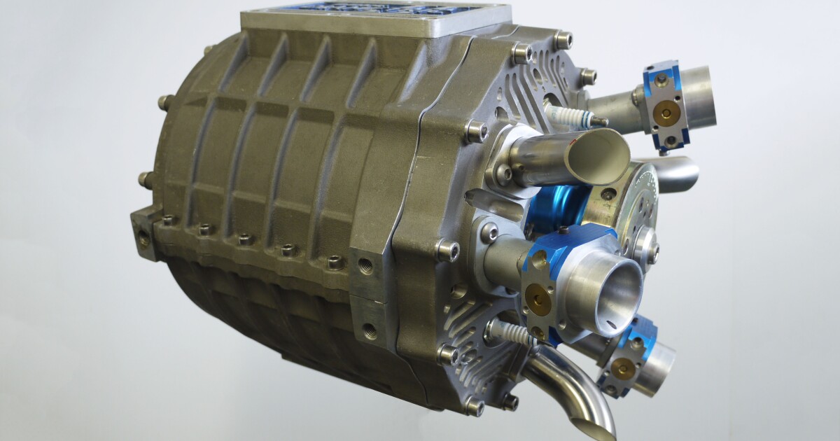

Just when I thought everything had been invented. Fancy one of these new engines in your car?
Duke Engine
The 'barrel' or 'swash plate' engine was invented a long time ago! And the Duke is a variation on that theme. Bristol IIRC did a Z-crank model which the Duke is very similar to.
What confuses me with the Duke though is that it appears to operate on 2-stroke principles - of which I favour. But the emissions regulators don't!
I've just browsed the page so maybe there's more info but there doesn't appear to be the valving a 4-stroke would require.
If they've licked all the problems associated with 2-strokes then they deserve to succeed.
Pistons and cylinders will be conventional so there is not much chance this Duke will ever take off unless outfitted with cylinder head valves. Valves do not need to be driven by cams. Indeed there are pub sized marine engines where the valves are externally actuated.
Looked at more closely and it is a 4-stroke. The problem they will face or have a unique solution to is sealing the rotating cylinder to the head face under pressure. Not an easy trick to pull off. Time will tell, but even if they've got it right the major manufacturers are so wedded to NIH syndrome Duke may well struggle to gain acceptance. Just ask Gomecsys...Originally posted by Thrumbleux View PostI've just browsed the page so maybe there's more info but there doesn't appear to be the valving a 4-stroke would require.Last edited by Thrumbleux; 05-09-14, 09:20 AM.
