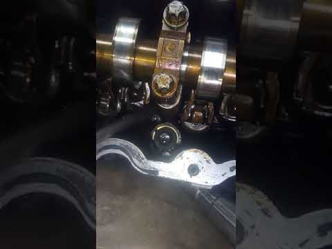

So I have taken off the cam cover and looked at the cam/valve gear.
It all looks Ok with nothing obviously broken.
When the cam is not pushing down on the valves there is a small amount of sideways play on the rocker end that is on the valve.If I then push down on the valve a couple of times the side play disappears .
This happens one all the valves.If I move the engine position the side play reappears .
Then valves that are being compressed by the cam are solid with no play.
Is this normal?
Should I be able to depress the hydraulic tappet end ?
Also I noticed the left exhaust rocker seemed to be very close to the cam post so I gently put a screwdriver between the rocker and the cam post and there was a click and the rocker moved away from the post.I could not see any damage to the rocker or the post.
Any ideas ?
Thanks

To my eyes the cam bearing cap isn't sitting properly - offset to one side with wear surface of cam peeking out. Suspect someone has been in there recently. And no, I wouldn't expect a hyd tappet to be so easily displaced.
I have had the cover off to replace the camchain but did not remove the camshaft.
Apart from the bearing caps what stops the can from moving sideways?
I am going to order 6 tappets is INA brand OK?
I have owned this car for 2 years so this is how the camshaft has been.
