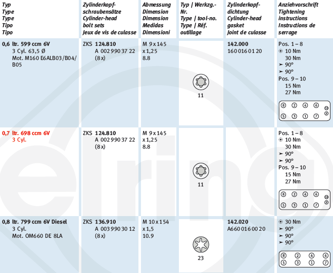

    I followed the FQ101 guide mostly, but when it came to angle tightening the head bolts - there are different angle tightening specs on different sights, I only did 2 lots of 90 degrees as specified on Evolution and not 3 as shown on FQ101.
    I didn't use gasket sealer on the head as it looked so clean. Would that be advisable?
    and any clarification on the head bolt angle tightening would be appriciated.
    Official smart documentation says 2x90 + 10 degrees, bolts not reusable, and there is tightening sequence.

              As regards torque and angle turn, it apoears you got that spot on.
              Elring, the German gasket maker also specifies 2x90 degree angle turn for the 0.6 engine. No mention of a ridiculous extra 10 degrees angle turn at the end.
                Note head bolts are only grade 8.8 and therefore normally no problem reusing. Obviously having first checked them to confirm they are not unduly stretched.
                  Retorquing head bolts in specified sequence sometimes cures problems like yours. Regrettably too late for that now.
                    Thanks for all this info Thrumbleux and Tolsen. I think I'm going to fit a new head gasket with some wellseal as an engine reconditioner has recommended it.
                      Give gasket time to settle after you have completed the two torque wrench cycles. Then slacken off each bolt in sequence and torque as per Elring.
