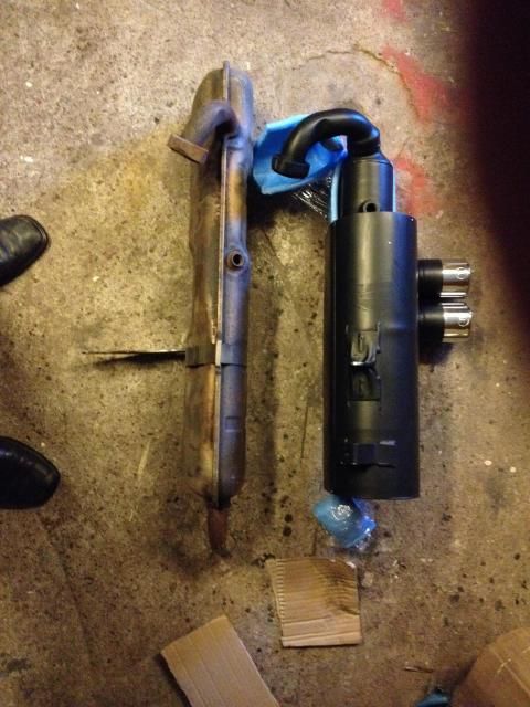

Brabus exhaust for Roadster?
The one on the right looks correct. You will need an upper and lower bracket along with the vibration rubber and screwWww.BigPerformance.Co.Uk

Ahh. Now you have told us its for a 45kw we have the full story. The exhaust on the right is for a Brabus roadater. The exhaust on the left is for a 450 and a 452 The turbo flange on the 101bhp Brabus has a wider outlet (8mm from memory) Either fit a bigger turbo or machine the header clamp on the brabus exhaust to fit your turboWww.BigPerformance.Co.Uk

I now understand why the 45kw exhaust did not fit when I fitted my "new used engine" to the wasp some years ago. I think there is a brabus turbo on it!
Unfortunately I am going to fit the new exhaust to the black car! It has a 45kw turbo.
I fixed the problem with the brabus turbo and the 45kw exhaust by drilling up the bolt holes a coulple of mm. Can I do the same to fit the brabus exhaust to the 45kw turbo?
Jörgen
To my eyes, the exhaust on the left is not a standard (82hp/60kwh in UK) Roadie exhaust, it's a 450 (or 45Kwh Roadie) exhaust, hence the issue. As Stnd (in UK) 60Kwh Roadies don't need new exhausts to use bigger turbos. Exhuast on the right is deffinetly a Roadster Brabus exhaust however.
