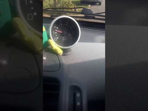

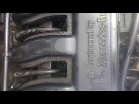

                            • #15
                              Some more soundshttps://www.youtube.com/watch?v=n7fwE_iH1xY
