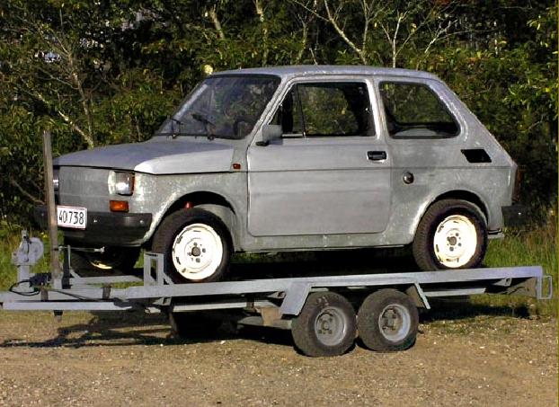

    This is roughly what a 126 looks like- with the engine placed way out back.
    A lovely libray picture of the polish fsm 126's

                        The photo of the BIS is exactly what the car will be like- not as the photo in my first post.
