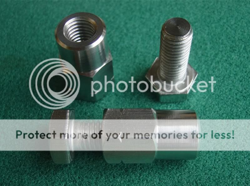

                Lower ball joint and steering knuckle are identical parts. It makes good sense on a high mileage Smart to renew wishbone complete with drop link and ball joint.
                Drop link is nearly impossible to remove from wishbone unless you use a special counterholding tool and special deep reach cranked ring spanner available at Lidl special offers, around GBP 3.99 for a set.
                Mark 1 version of special counterholding tool seen in centre of photo. Lidl's special deep reach cranked ring spanner just below.
                Mark 2 special counterholding tool made from an M10 Hex studding connector and M10 bolt.
                You can modify your front bearings for oil lubrication. Oil can be topped up in a minute or two. Oil lubed bearings last longer than grease lubed bearings.
                Always hang on to used front bearings. You can make a good front bearing out of two worn out bearings.
