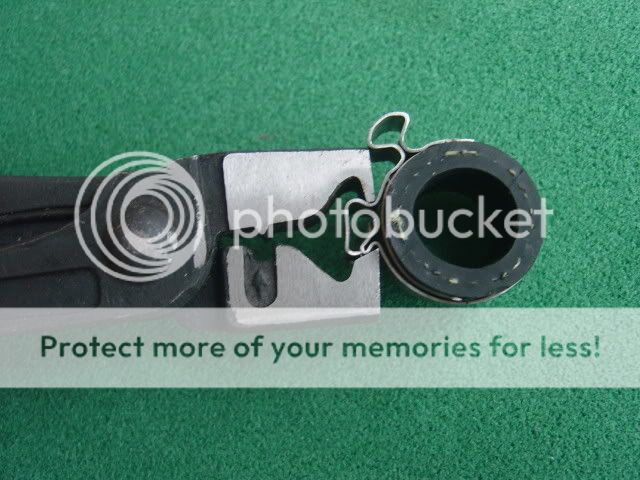

              All hose clamps fitted are the Clic E or R type. You need a special tool to reuse these.
              Clic hose clamps are easy to open without any special tool. Just pry open the catch using a suitably sized flat bladed screwdriver from the side.
