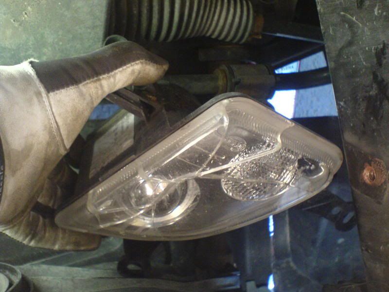

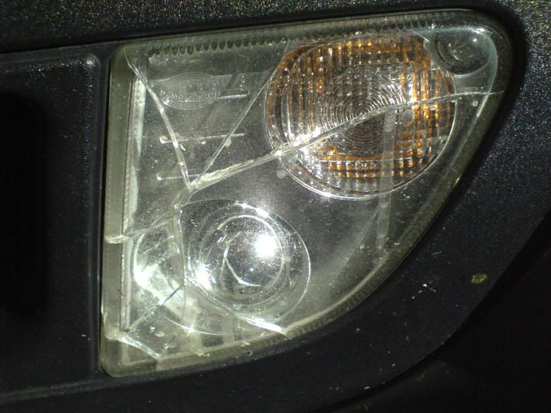

Problem!

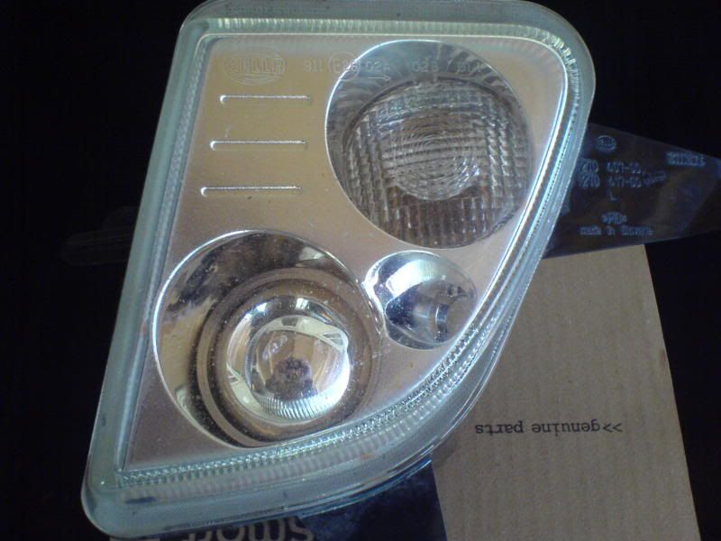

Solution
This how to is only for changing the left flasher/parking light unit. (On a left hand drive Roadster) The right hand one is much worse

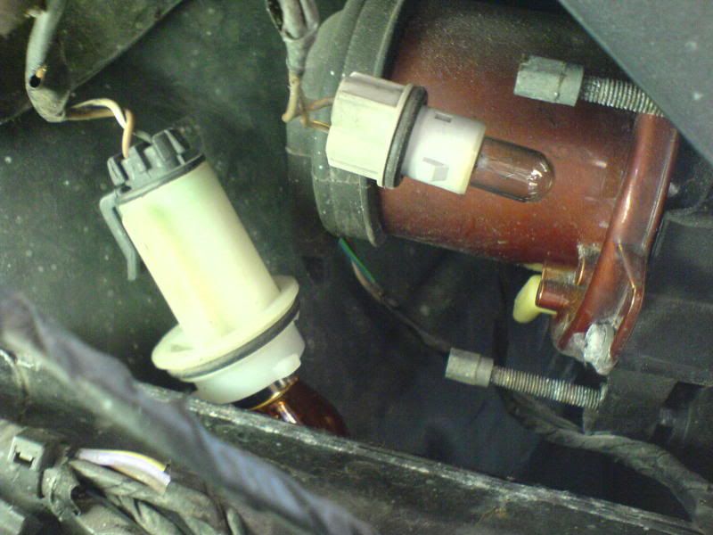

Remove the parking and flasher bulbs and get the wires out of the way.

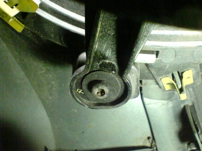

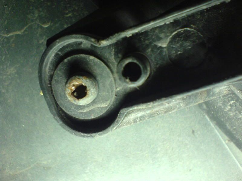

Remove the 2 retaining screws holding the unit. Side mount
Lower mount,

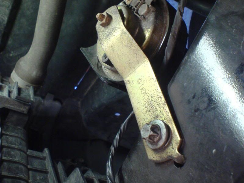

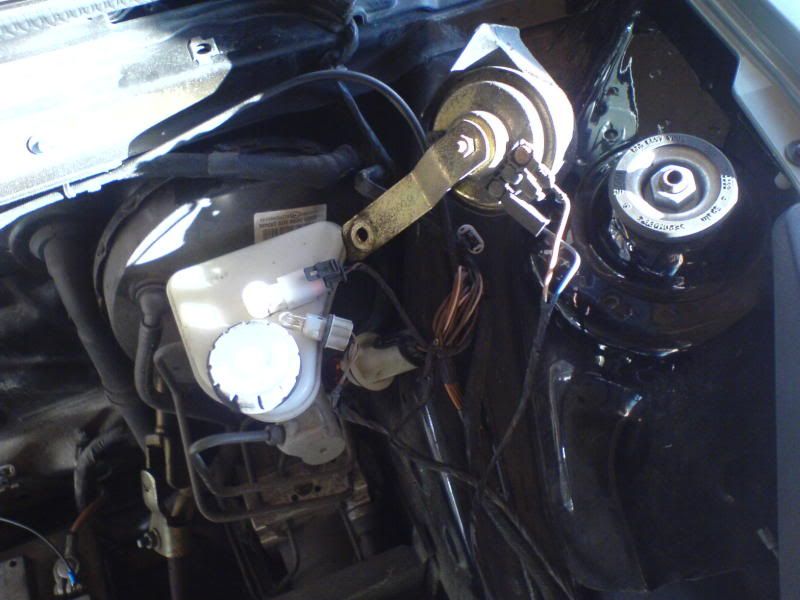

Remove the horn

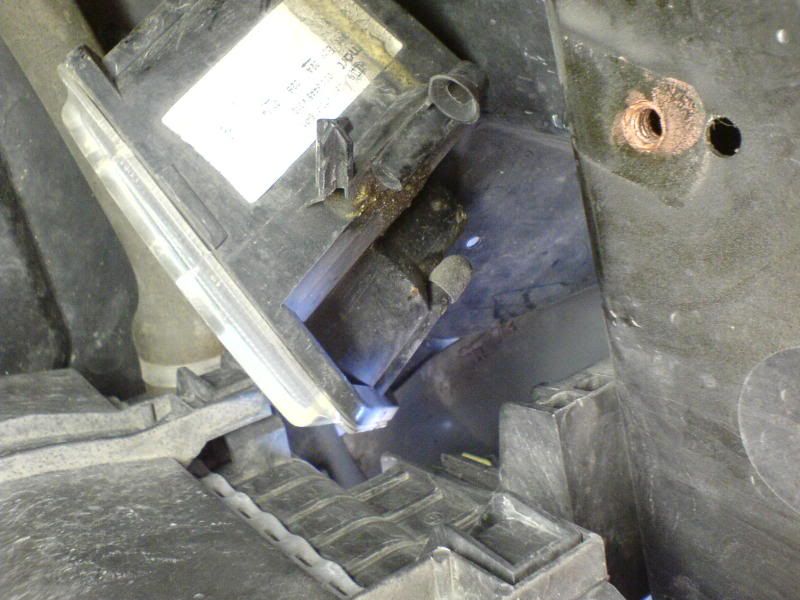

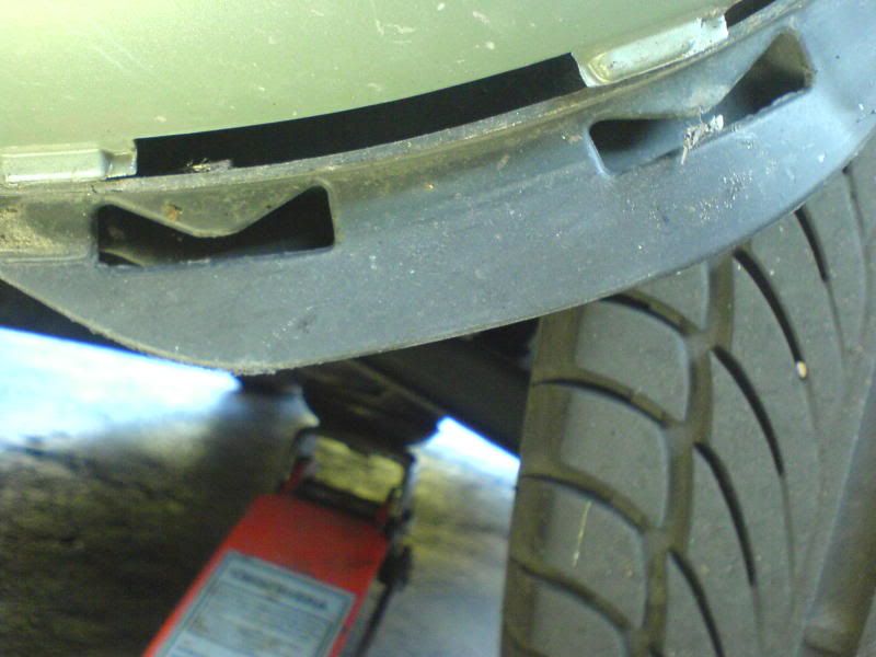

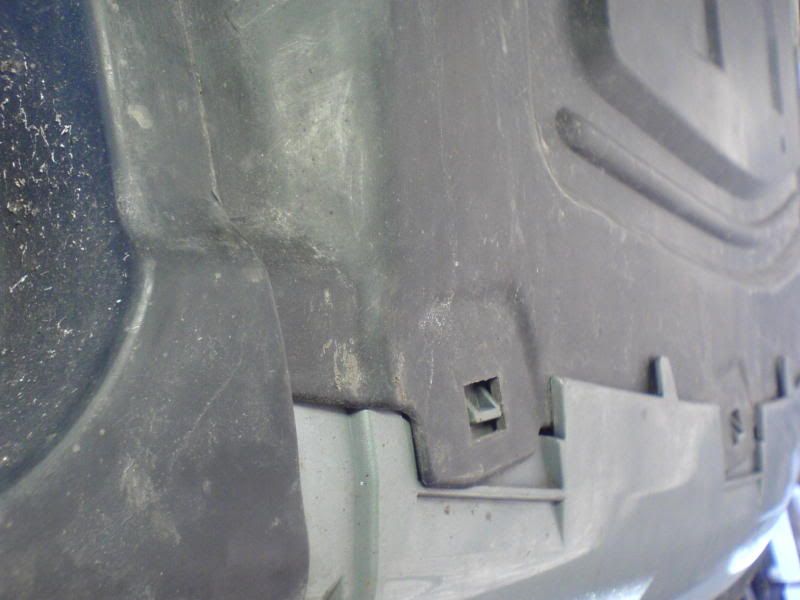

Loosen the front of the inner wheel lining.
Now You can flex the inner wheel lining enough to get the unit into the luggage compartment.

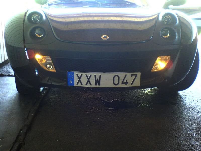

Install in reverse order as allways
Job done

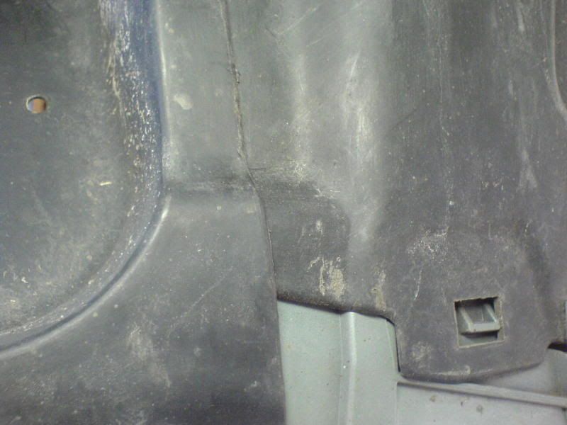

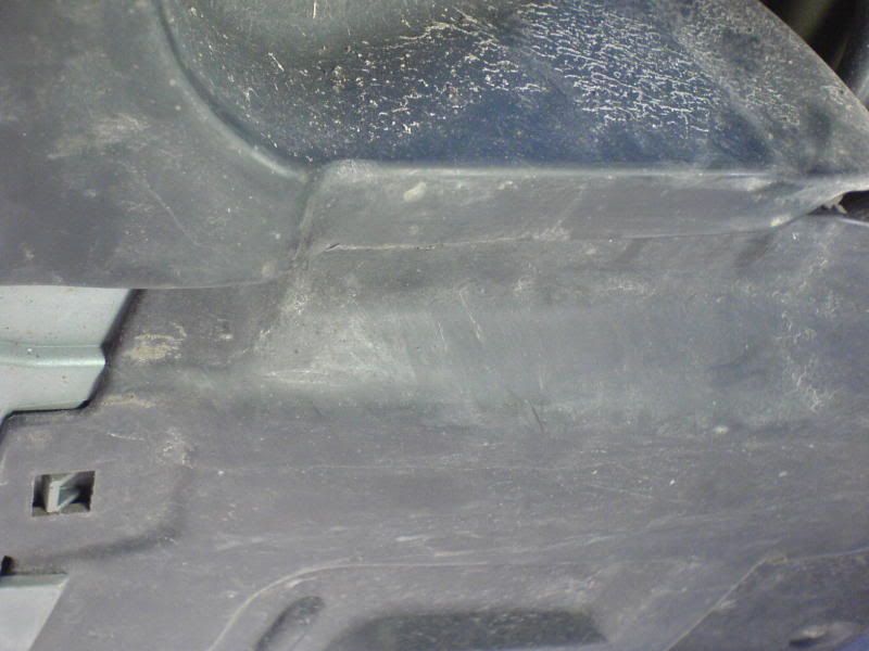

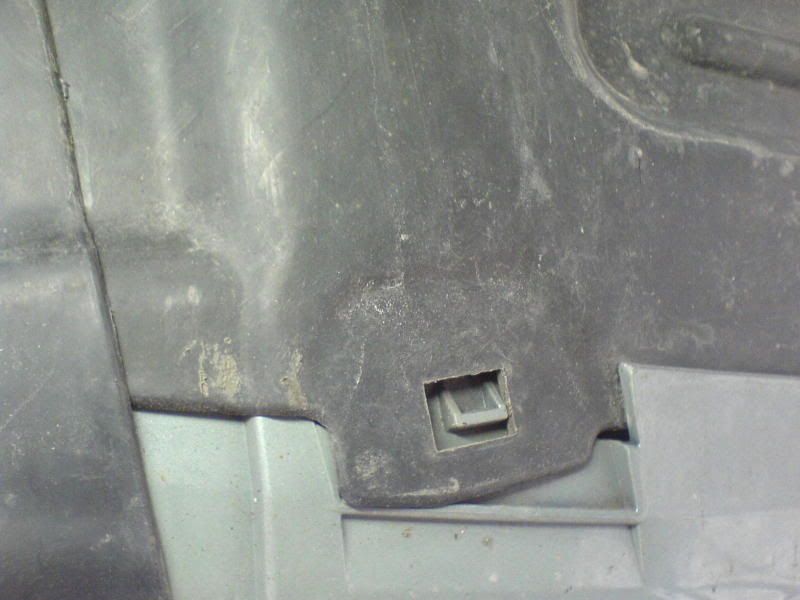

This is how the plastics under the front should look like when You are ready.
It could be cleaner!
