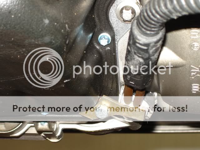

    Pan heater passed its first test with flying colours. Filled with 2.6 litres of fresh Lidl oil. Turned heater on. Maximum temperature reached was 55 C. No discolouring of the oil hence to evidence of oil being burnt. Ambient temperature at time of test was 0 C.

                    Now convert oil pan one with drain plug.
                    Drain plug will be summer magnet resistance and winter.
                    Hole for plug seat and component ,
                    drain cap chair,
                    drain plug (for summer)
                    • #25
                      Why summer and winter? You intend to fit heater element for winter? Why not leave it fitted permanently?
                      • #26
                        For winter - screw cap with heating element .
                        For summer - screw cap with magnet .
                        Changing a resistance heating is undesirable - decreases reliability.
                        The heating element is sealed at the factory but can attach the screw plug.
