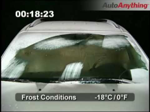

                  OE devices are made with incandescent glows plugs.
                  https://www.pieseauto.ro/alte-piese-...908645915.html or
                  The efficiency of these devices is indeterminate but I think they are ineffective. The incandescent spark plug has been optimized to work for short periods at high temperatures (800 ... 1000C). At low temperatures (-15 ... + 30C) the operation is of some efficiency because it was designed to work in the air, not in the liquid.
                  The solution from the car manufacturers consists of blowing hot air onto the interior of the windscreen (in the cabin) or electric windscreen wiper, similar to the rear window but with invisible electrodes. https://www.youtube.com/watch?v=GIhZsVwFJlQ The other way is to use the capacitor reactance. https://www.youtube.com/watch?v=BmpROemcd4E
                  Reducing visibility by changing the diy windshield first comes to the driver. From a legal point of view, it is "the key to the prison".
